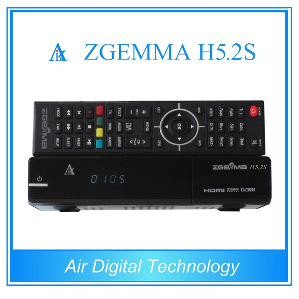

Sezione dedicata ai decoder Zgemma H5.2S plus ( dual SAT + tuner DTT )
Nome: [IMAGE] ZGEMMA H5.2S (H5series) Nemoxyz SATtek CBGInterstellar v5.6 openATV v7.6 - Py3 branch OE5.6
Autore: Nemoxyz
Descrizione: https://i.gyazo.com/42feb638ee6a6b97abe0cd0d745a99f3.jpg
VERSIONE SOFTWARE & SORGENTE
OFFICIAL-IMAGE-SATtechnology: Ver1 - 10-NOVEMBRE-2025
MODELLO DECODER
Adatto ad un decoder Enigma2 ZGEMMA H5.2S H265ready ( CPU MIPS )
https://i.gyazo.com/3964d6a39c3c3482e2746017aa088083.png
FEATURES:
