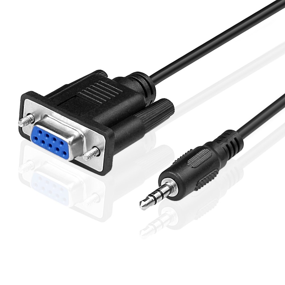

-Cavetto seriale jack-com
https://www.amazon.it/Cavo-Null-modem-RS232-jack/dp/B075GTQLLC/ref=pd_bxgy_23_img_2/261-6921731-5898665?_encoding=UTF8&pd_rd_i=B075GTQLLC&pd_rd_r=1f2830e5-f216-4ca6-89d7-27229c595a05&pd_rd_w=DFnM1&pd_rd_wg=I1z6W&pf_rd_p=931cc5fd-a5c3-411b-95f4-73b17b256f71&pf_rd_r=R77CBE7W7DCR2HV99Z2G&psc=1&refRID=R77CBE7W7DCR2HV99Z2G1-19&tag=nemoxyz-21

Dietro il decoder ci sta ingresso rs232 a jack non ci sta la porta com
